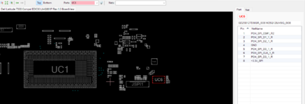

GD25B127DSIGR_SO8 W25Q128JVSIQ_SO8
16mb
Main Bios Chip Detais and location.
16mb

The BIOS IC on the LA-G861P motherboard is typically designated as UC5 and is a Winbond W25Q128BV chip
please check carefully
those information are from trusted sources
this motherboard UT2 and UT6 are related to bios
please get those backup files so we check the size of files
